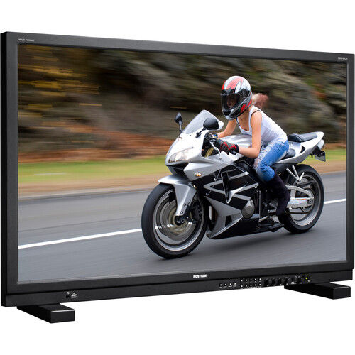

Postium Korea OBM-W420 Overview
Monitor your 4K studio or field production with the OBM-W420 42" HDR 4K LCD Monitor with 12G-SDI from Postium Korea. With full input support for signals up to 8K60, the OBM-W420 offers 1920 x 1080 display resolution and a 178° viewing angle, with a brightness of 700 cd/m² and a 4000:1 contrast ratio. It features two 12G-SDI inputs, which can handle resolutions up to 4K60, and two 12G-SDI outputs. An HDMI 2.0 input and one SFP optical input provide additional options for bringing in video with embedded audio, and a 3.5mm line input offers analog stereo connectivity. A 3.5mm analog stereo output allows you to monitor sound via optional headphones. There are also component and composite inputs for analog video. The monitor comes with its own power cord.

Postium Korea OBM-W420 42" HDR 4K LCD Monitor with 12G-SDI
SKU: OBM-W420
$7,232.50Price
